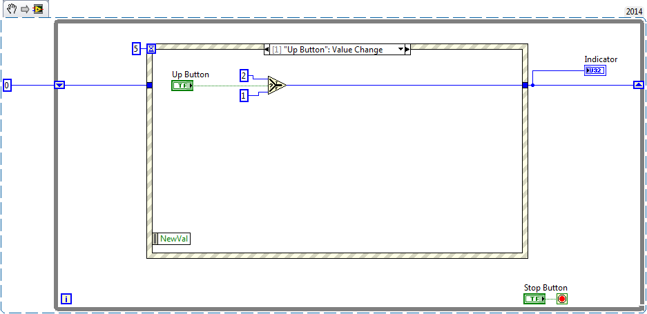

The behaviour of the latch-until-released behaviour of switches seems a little strange to me and I was wondering if anyone would shed some light on a question I have about it.
As a quick experiment I created a very simple VI containing just a while loop with an event structure, a couple of latch-until-released boolean controls, and a numeric indicator.
 What I expected was that the indicator would display "2" while one of these boolean controls was depressed and "1" after releasing it. What I found was that it displayed "2" after pressing the button but remained that way after releasing it as well.
Using the event inspector window, I verified that this event case was firing both when I pressed the button and when I released it, but in both cases it seemed to be reading the button as "true". I find this really odd - wouldn't it make more sense for the button to be read as true in one case and false in the other?
To get the intended behaviour, I had to do something pretty ugly:
Since the button seems to be in the same state in both executions of the case, there's no way of differentiating between press and release events except by keeping state external to the event structure. My question is basically: why have the LabVIEW developers chosen to design it this way? What's the logic behind it?

That's correct, but the issue here isn't so much when the value changes (the value changes in the way I expect), but the choice LabVIEW is making about when to sample the control's value and generate an event. When I press the button and generate an event, does LabVIEW update the state of the control and then generate a Value Changed event? That would make sense and it seems that's what's happening when I press the button. However, when I release the button, it seems to be generating a Value Changed event and then changing the state of the control.
This diagram might make this all clearer:
> Not if the READ is the CAUSE of the transition.  They do it this way so you won't miss a transition (especially back in the days before EVENTs - you had to poll the buttons to respond to them).
If that's the case, is there a way that I modify the program so that I can read the control as false when I'm releasing it (which would be more intuitive and make the program a lot simpler to write)?
> You mention having to do something ugly to "get the intended behavior", but I'm not sure what your intent is.
My program is ugly because I have to keep boolean values going through shift registers and switch their values within the Value Changed event case. I have to do this because I read a boolean control as "true" both when pressing and releasing it, and therefore I have no way of differentiating which situation is happening within the event case itself - I need to maintain external state to "remember" if the button is currently pressed or depressed to figure out how I should update the numeric indicator.
My intent is just to update a numeric value to one particular value when a button is pressed, and another value when it's released.

In your event structure, you have an OLD VALUE and NEW VALUE supplied to you.  You can do logic with those if you need to further distinguish the transition.
Consider using just the SWITCH UNTIL RELEASED mechanical action,
That generates a VALUE CHANGE event on press and a VALUE CHANGE event on release.  You use the NEW VALUE to distinguish which.

With the "latch until released" mechanical action, these values are the same for both the press and release case, so you can't make a distinction.
Thank you! I hadn't looked at the switch mechanical behaviours closely enough because I assumed that all switch actions 'permanently' changed the control state (i.e. made it so the user would have to click the button twice to get it back to its original state). I ought to have looked closer at the diagrams. This gives me the behaviour that I expect.
