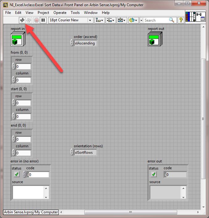

Here's "Excel Sort Data.vi" showing the error.  I never modified this VI.  But the Bug is reporting "One or more required inputs to this function are not wired or are wired incorrectly".
I guess we could get creative and start modifying this VI to fix it.  I don't call this "Excel Sort Data.vi" directly, but, perhaps other VIs do call it.  In a pinch I may need to disable this VI and compile...to see what happens.
