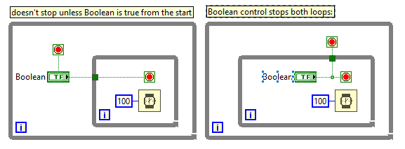

I am using this timed structure that is new for me and I am having issues on how to stop it and not losing  my data.

PS2: From my desk now. What I want to do is to be able to stop the program and still have my data recorded, but the stop button does not do that. I try to place it inside the loop, and does not work or stop data. How is the basic machine state for this?

Where is your code running?
I would only use timed loops on a real-time or FPGA target.
In Windows, you are at the mercy of the operating system for the timing of anything that happens.  You might as well use a regular While Loop.

That stop button is outside the inner loop.
It's value is read, then entered into the inner loop. If the control changes, the value of the wire doesn't (dataflow 101).
Put the Boolean in the inner loop, and when wire it to the outer loop. If the Stop control stops the inner loop, the value will go to the our loop and stop it.
Recreate these diagrams, and see what happens with highlighted execution...

Thank you for the kind answer. I almost sure that I had try that first, but I guess that something else was not working and was throwing off my vi.

I find out why I did try something different...
Because I am using a delay of 1min inside the loop, I thought that was not working... But it simply was that I was not being patient...
