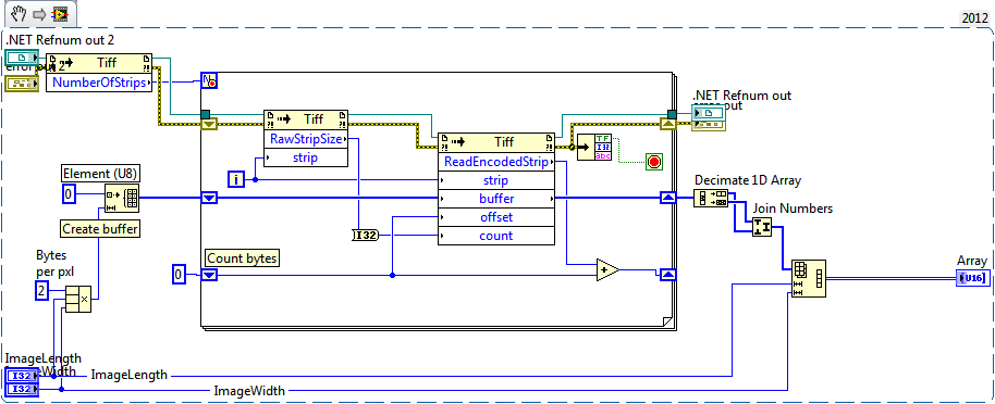

I am attaching the converted VI along with the original from the libtiff2 library. One problem I ran into is that the ReadEncodedStrip function only provides an U8 buffer, while the original in the libtiff2 library sems to adjust to the data type. I suspect that eiher there is another function for U16 and U32 values, or a function that allows setting the data type, but I was unable to find any. Any hints?

Hi Peter,
it looks like it did not take care of that itself.
Here you go:

Thank you so much, stran.
Since I have LabVIEW 2011, I cannot open it though. I recreated the code using your attached blockdiagram image. It works, but I noticed that it executes slow taking 54 seconds to load a 2560x2160 TIFF file.
I uploaded an example tiff file of the kind I am trying to open to https://www.dropbox.com/s/pjhts95npvpvnzf/New_Channel_0__B_003_r_0001_c_0002_t_0000_z_0004.tif?dl=0, since it is too large to send as an attachment.
Is there any more efficient way to load this? Thank you so much for your help.

This won't solve the whole performance problem, but try "swap bytes" instead of decimating and joining. It's probably faster and more efficient.

Thanks, Nathand. Swapping bytes reduces execution time from 54 to 53s, and the image is corrupted (looking similar to a solarized image). The bottleneck is the ReadEncodedStrip node, which requires 18ms to execute for each of the 2560 strips. Decimating and joining the array adds 253ms to the total execution time, so is negligible in comparison.
Oops! Sorry, yes. That was sloppy of me, didn't look carefully enough at what's happening. You would need to Type Cast the array of U8 to an array of U16, then swap bytes... but at that point, it would be better to convert the array of U8 to a string (this is essentially free, shouldn't require reallocating memory), then unflatten from string into an array of U16 with the endianness set properly. Not sure if that would be any faster, but it's easy to try.
I'm curious if a pure LabVIEW solution like the one I posted earlier is any faster, but I don't have time to investigate right now; maybe this evening. I don't know how efficient LabVIEW is at handing large data structures back and forth to .NET code.

I tried flattening the U8 array to string and unflatten to U16 array, but this produced:
Error 116 occurred at Unflatten From String in Read Tiff File (Bitmiracle libtiff.net) Fixed.viPossible reason(s):
LabVIEW:  Unflatten or byte stream read operation failed due to corrupt, unexpected, or truncated data.
Typecasting the U8 array to string and unflattening to U16 array produced the same result. As I said, the conversion is currently not the bottleneck.
Sorry I was unable to open your earlier code since I need it in LV2011. When I looked at your block diagram picture I decided to continued pursuing the .Net solution first. But now, if you send me the code in LV2011, I am ready to give it a try and convert it.

Did you set the Unflatten input for "data contains array or string size?" to False? If not, you'd almost definitely get that error. Otherwise I'd have to see what you're doing to understand the problem, but it sounds like that's not worth pursuing right now.

Yep. The "data contains array or string size?" input was still TRUE. The error went away, but the image still looks corrupted. I will wait until you find time to convert your VI. Thank you so much.
