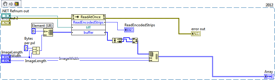

Hi Nathand, Peter,
You were right about this back and forth in between Labview and .Net.
I have put the whole loop in a .dll and it now executes in <200ms including byte swapping.
If I'll have time I might do this for the writer part as well.

Here's an update. This code comes close to doing the right thing with your image, in pure LabVIEW. Saved for 2011.

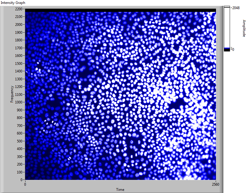

Glad you got it working, and thanks for the link to the code.
I used as a test image for my code, the image you uploaded. It didn't occur to me to use an intensity graph for display though, as the code you uploaded does. When I drop an intensity graph on the front panel of my VI, and connect the image data to it, I get the image below. Just out of curiosity, is it correct (if perhaps rotated or upside down)? If so, my code does what you need. The code you posted is more comprehensive, although rather dated in the way it's written.

Hi nathand,
Glad you got it working. My image is grayscale, and it is rotated 90degrees counterclockwise compared to the image you posted. I paste the image in its required orientation:
I already have the rotation of the array implemented albeit slow. Did you benchmark your load time or can you send me your code, please so that I can test it here? Thank you so much.
