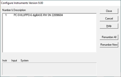

Hi Paolo,
I worked on a Labview VI to see if it communicates with the ortec device, its not communicating on mine. I am attaching the program here. Could you give it a try and see if it works on yours? That way I would know if its an error on the programming end or some troubleshooting that i have to do on the device or other areas. Please let me know about any suggestions or feedback on the VI.
themadgreek
Message 26 of 28
(1,556 Views)
Accepted by themadgreek
It works but you need to use an ActiveX Container:
Then insert in the container the UMCBI Connection Control V2 as already explained.
This control does not need an Automation Open, just wire it to the Address property node.
EDIT: Address is not the IP address, rather the instrument number given by the MCB Configuration program; in this example is 1:
Paolo
Message 27 of 28
(1,552 Views)
Hi Paolo,
It worked now !!! Thanks a lot for helping me get it to work, really appreciate your help, time and patience.
themadgreek
