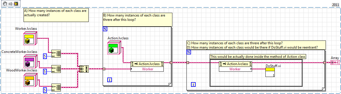

Now, let's say I want to create class hierarchy, which is defining the behaviour of some other class (a Strategy pattern). No class in the hierarchy contain any mutable data, they're only redefining some methods. I've visualized this in the following picture:
Project with this VI is in the attachment.
So, here are the questions:
  1. What is the size (in bytes) of LV Object? Whis question can be splitted into two: what is the size of actual object, which is stored somewhere in memory, and what is a size of a pointer to this object?
  2. If I create class, which has no data, just some methods, what is the size of the object of this class? According to the whitepaper fragment above, there should be only one instance of this class in the whole application, and everything would point to it.Therefore the answer to this question would be exactly the same as the answer to question 1?
  3. Folowing question 2: if the class methods are not reentrant, there is also one and only one instance of each in the whole memory?
  4. And all of this leads in fact to single question: if I use such pattern, I only "pay" once for allocating all my "Worker" objects in memory, and then LV simply reuse them?

@Aristos Queue wrote:
On desktop, there is one and only one default value object per class which is shared and has copy-on-write semantics. On RT, every instance that LabVIEW needs is separate. This logic is the same whether the object has data fields or not.
So, in my picture from the first post (let's assume that DoStuff.vi does not modify Worker data in any way, only read it): on desktop there would be one instance of data for each class: Worker, ConcreteWorker and WoodWorker. And on RT there would be 5 of each. Am I understanding this right (I think I can see good reasons for such approach for RT)?
I have no idea what you mean when you ask what the size of a pointer to the object is. Obviously a pointer to any data is the size of an address on your system, so I'm guessing that isn't what you meant.
I'd have no idea either, now that I'm reading my question Smiley Very Happy I meant the size of everything other than data itself. And the answer to that is: the size of three pointers. Ok.
All of which leads to your question number 4, and my answer is that you can write such zero realloc programs in LabVIEW depending upon the code you write.
So far I understood that if I don't mess with the class data in any way other that reading it*, LV won't create another instance of data for this class objects (at least on desktop, RT is my main concern now). And this is useful information, especially if I want to create hundreds, maybe thousands of objects of the same class in my application.
*which would obviously create copy of the read "variable" itself, by branching the wire, but not the copy of class data itself.

In the picture shown:
When you first hit the run button, there are 4 objects on the block diagram, one in each of the four constants. The Action object has a worker object inside of it (its default value). I am ignoring anything on the front panel on the assumption that if you were using this in an application the panel would be closed.  Total: 5
After section A, there are 6 objects of each of the Worker classes (5 in the array and one in the constant) and 1 Action object (in the constant) and another worker object inside that. In this particular case, I think that toggling debugging has no effect on the count, but in many cases, any interim steps would evaporate when debugging is turned off. Total: 20.
Running B will copy each element of the array into the Action object, leaving the array behind. Shouldn't those objects be moved into the property node? No. LV leaves the array in place -- it is already allocated if this entire VI gets called a second time as a subVI. So you now have 34 worker objects and 16 Action objects. Total: 50
C is curious... C will not make any further copies of the Action objects as it runs, but because you used the Property Node, you're guaranteed to make a copy of the Worker object when you read it. Because the property VI will only conditionally fire based on the error cluster, the property VI forces a copy. An unconditional VI call may or may not make a copy, depending upon many many factors, but mostly depending upon what happens downstream. Since you say that the square region would be done inside a method of Action, put that inside an Inplace Element Structure and use the Unbundle/Bundle pair and you remove the guarantee that there will be a copy made. There might still be a copy depending upon what you do in that subVI, but the probability shifts in your favor. I can't think of a scenario where an unmodifiable object would be copied going into a local subVI call (even if the subVI is reentrant or dynamic dispatch) but the LV compiler might know of a case, so I won't rule it out -- there might be something involving UI thread priority or something weird that I haven't thought of.
BUT, there will only be one object at a time, so after the loop runs, there will only be 51 objects total -- that new one is the final copy made inside the loop which remains allocated. 50 if you switch out for an inplace element structure.
When you call this subroutine a second time, those allocations are already made, and they get reused. So assuming you use the inplace element structure, there is not a continuous memory bloat when you call this multiple times in succession -- your memory level holds dead flat.
