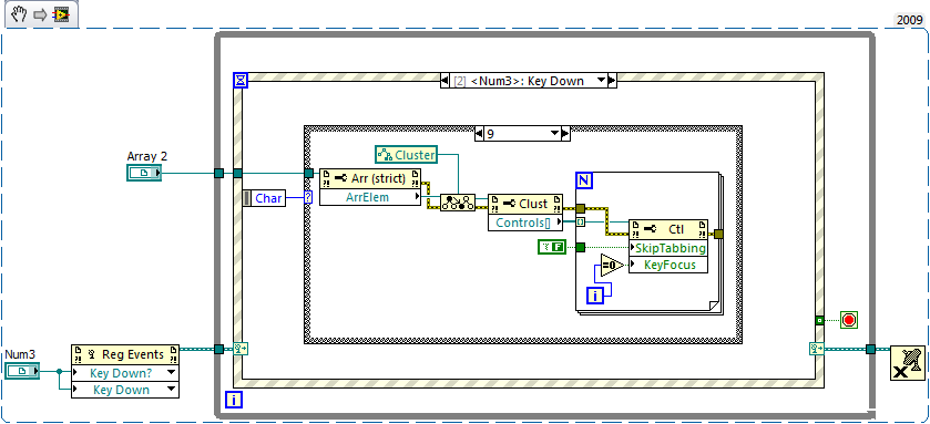

ok here it is FAR simpler, using "dynamic" event registration.  Basically the event registration lets us create event cases for anything we can create a reference for.  If you use a reference to an array element, it catches the event(s) registered for any of those elements.  Why this is not available in the basic events menu is beyond me.
The strategy in the following VI is to catch tab key-downs in the last control of the cluster's "row".  using a filter event, we turn off tabbing before the key is processed.  when the key is processed, we get references to the cluster's controls again, turn tabbing back on and set keyfocus on the first one.
Yamaeda, the answer to your suggestion is that generating a "+1 to array index" isn't possible.
18427iFF85D5C413AEFDF1
