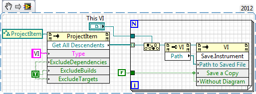

Is it possible to programmatically save all?
Does anyone know if there is a method available to do "save all" just like you would from the project? Or do I have to get all the VIs from the project recursively, myself? I don't see a method for it from invoke nodes wired up to a project reference. Just trying to avoid reinventing the wheel.

Accepted by topic author GregFreeman
Should do

Found this on LAVA
Edit: woops, jeff beat me to a solution

@JÞB wrote:
Makes me curious... is that BD open ?
Which BD? Also, I will be using a method to open a project reference which this VI doing the saving is not in. So, I won't have a static project reference in my code and this VI won't be saving itself using this method, since it won't be executing the save all on the project which contains it (if that's what you are getting at).
Edit: Darren suggested I load the main VI's into memory first, because this VI has no caching and tries to open each library/VI individually, save, then close. But, even when doing so this method is crawling. It takes upwards of 5 minutes to save the 700 VIs in the array. But, if I close the project and it says "you have 108 unsaved VIs" and I press save, it takes about 3 seconds to save them all. Suggestions on this?

@for(imstuck) wrote:
Which BD?
The Lava Link-  I was mobile last night and couln't look into this
Seams to be open
As too the LAVA Code working slowly.  I would guess that a "Defer FP Updates" might help a bit around this code since this VI is going to hog the UI Thread.
Migrating the Loop invarient constant "Not a Refnum" outside the case in the loop may help too. (Just guessing with the compiler optomizatione but I don't think it will auto-migrate from inside the case)
A CLF node pointed to the right call in LabVIEW.dll is another possibility but I would urge extreeme caution! (This path I fear to tread without a very good backup)

After some more thought....
A few edits to the referenced code.
  • changed error merging to outside the loop
  • migrated Not A refnum and library VI server constants
  • Wired error through all cases (No more look-ups for the default error cluster def inside a loop)
Should speed it up by some (Try it and post results if you can)
A "(VI,Library)" wired to the project Item type filter may also help by reducing the size of the auto indexed array.  but the Help is unclear as to how to get multiple filtered types.  I would need to play with it some

Saving from the bottom up* used to help with the saves.
Ben
* Bottom up = The VIs with no dependacies get saved first then the VI above them and work you way up the hierachy.
