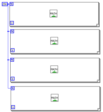

Implicit prallelism!
Old way
New
No longer do we have to split up arrays and pass to a bunch of prallel For loops.
For those that have not tried it, when running on a machine with a bunch of proccessors, breaking up large arrays across many For loop would share the load across all of the processors. BUt with this new feature LV will do it for us....
Plus...
I don't have to re-write my code for machines with even more cores!
