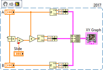

I'd guess the intention is to make a smoother curve. Interpolation won't help.
So simply interpolation between all Re values of the first and second array, and I'm values of both would be useful. If the first array is a measurement, and the second is a measurement too, the result would be a measurement in between.
That would simply be a matter of
1) split the array1 in Re and I'm arrays (complex to Re\Im)
2) split the array2 in Re and I'm arrays (complex to Re\Im)
3) Interpolate between array1.Re and array2.Re
4) Interpolate between array1.Im and array2.Im
5) merge the results with Re\Im to complex
3) and 4) is simply  (b-a)*I+a.
Might post a vi tomorrow if nobody done so by then.

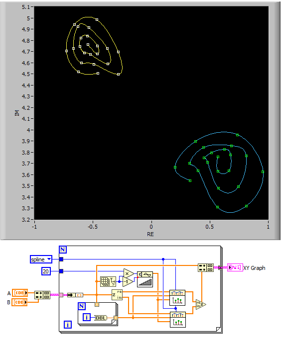

Well, he could do a spline on RE and IM as a function of array index (e.g. time) with 10x more points. (example)

Well, here's what my assumed solution looks like. Slide=0.2.
Would be nice to get any feedback on what OP wants...

Looking at Christian's lovely Spline drawing, it suddenly came to me what "interpolation" might mean (or certainly a case where it could be useful).  I'd noted earlier when I saw the original plot that these two curves looked similar.  So let's assume that they represent a set of ordered points (perhaps coordinates of a path on the surface of some deformable object).  Let me further assume that I take two "snapshots" of these points at time T0 and T1, and I'm interested in how the underlying object "evolves" over time.  So I divide the elapsed time, T1-T0, into N intervals, and make a movie where the first frame is the curve at time T0, Frame N+1 is the curve at time T1, and intermediate frames are interpolations between the two curves at position i/N (hmm, I may have an "off-by-one" error here, but you get the idea).  As you watch such a movie, you'll see it start with one curve, the smoothly translate, rotate somewhat, and maybe get some distortion, ending up as the second curve.
It is an entirely separate question if this is a sensible thing to do, and if this is what the O.P. is trying to accomplish ...
