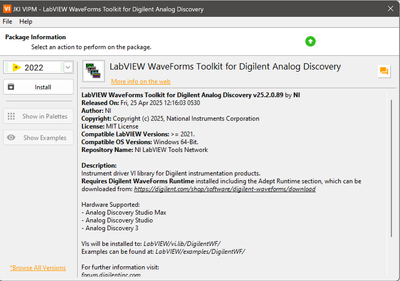

Hello NI Community,
I’m currently working with the Analog Discovery 3 Pro Bundle and would like to integrate it with LabVIEW for data acquisition and signal analysis tasks. I’m reaching out to seek guidance or examples on how best to achieve this integration.

Hi
You need to install software from VIPM.
For the first time in many years, a new LabVIEW support package were introduced to support AD3 :
Regards
(738 Views)
Accepted by topic author VikasND
Good to know there is an update. I used the previous version with an AD3 before the package update came out and had no major difficulties.
Here is a link to the package: https://www.vipm.io/package/digilent_waveforms_vis/
