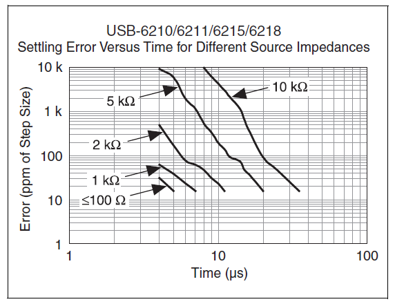

The other spec you want to look at is "Settling Time for Multichannel Measurements". Depending on the accuracy you want you have different settling times. For instance, the most accurate reading requires 7 us of settling time. With 10 channels you need at least 70 us between each sample clock tick.
Finally, if all the readings are on the same task using channel expansion then you will know that at least all the measurements are one-to-one (each measurement  cooresponds to a single sample clock cycle). You can use a property node to set the convert interval (not exactly the settling time for the multiplexer, but a useful description for now). If you set the convert interval, you can predict the exact phase difference between the measurements on each channel.

The time between consecutive channels is very easily quantifiable--it is the inverse of the convert clock rate.  The convert clock rate can be set via a DAQmx Timing Property node.  If you want to minimize the delay between channels, you should set the convert clock to the highest rate (250 kHz on the 6218 according to the spec).  If your signal sources have a high impedance or you have high accuracy requirements you might consider a slower rate to minimize settling error between channels (the convert rate of course must be >= sample rate * number of channels):
If you don't explicitly set a convert clock rate, DAQmx will pick one for you.  The idea of the DAQmx algorithm is to split the difference between reducing settling error and minimizing time between channels.  If you have specific requirements I'd suggest explicitly picking a convert clock rate that meets them.
