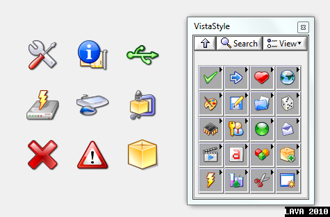

I really (really) like the UI Tools distributed via LAVA:
And especially the Vista Pack, they have nice visual effects.
Ton
Oooohhh... those are nice.

Agree, very nice....question now, how do I install it.  It is showing ogp?  Am I missing something?
TWK
No you're not missing anything obvious.
An OGP file is an install file that can be installed usint VI Package Manager.

Very nice icons.
Got another question.  I installed it, but under my user lib on front panel, it is now showing up.  Is there a way to refresh or get this added?

It should automatically refresh (at least that is default for VIPM).
Perhaps is installing the Lava LIB UI tools the solution (link).
