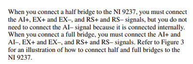

The full bridge sensors have only 4 wires - red (+excitation),  black (-excitation), Green (- Output signal) and White (+ output signal) which are connected to AI+, AI-, EX+ and EX-. The NI-9237 operating instructions and spec state "for a full bridge you must connect the AI+, AI-, EX+, EX and RS+ and -RS signals".  Kindly see Figure 3 of the NI-9237 (with RJ50). I have RS+ and RS- left unconnected, I am using an example vi with null offset and no shunt. But I end up with readings that require gain adjustment. Hence confusion prevails..
What happens when you connect RS+/RS- with EX+/EX-, respectively?

When I connect RS- with EX- and RS+ with EX+ the response of the pressure sensor is a flatline on the test panel.
Without the connections with RS+ and RS- the response of the sensor is as shown below
The operating instructions state the following and provide the connection diagram. You must connect AI+ and AI-, EX+ and Ex-, and RS+ and RS- signals. However it fails to indicate what to connect with? Just poor wording...
The instructions indicate options to correct for resistance errors: remote sensing and shunt calibration. Per your suggestion I have followed Figure 4 and I get a flatline....
Thank you again for your guidance.
All the connections are shown in Figure 3: how does that image "fail"?
Figure 4 is just a "boil down" of Figure 3 for those 6 connection lines…
Can you test your sensor with a simple power supply and a DMM?
Can you provide a datasheet of your sensor? I couldn't find one for the type number given in your first message.
