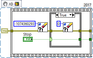

i am using software trigger with basler camera but if i start the program and dont take a trigger within 5 sec (which the timeout set) the error occur so how can i ignore this error or make camera start with snap mode not grap mode

An apparent approach of adding a "Clear errors.vi" would also work for playing with this.
You already have it in the code with input 0, just copy it and use the input of -1074360293.

i do it but same error
what i want is that if i dont send the trigger the error appear and the application close
so i want if i dont send  the trigger signal this error dont appear and the application contenous

It seems that you are missing the "-" (minus) in the numeric constant before 'clear errors.vi'.

Please return the input of 0 as it was before, copy the "Clear errors.vi" function and insert it outside of the case structure right in front of it on the error wire.
You need to set the input value to be -1074360293. Make sure the value is negative, as otherwise the timeout error is not cleared.
So something like this:
