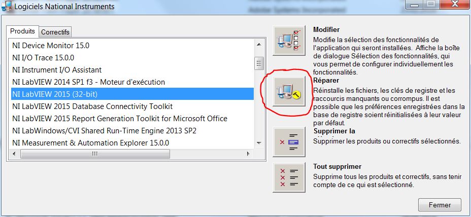

Repaire done ... still no Glyphs (except archive that I downloaded from NI site), no templates.
I've xecuted this option (please, see the screenshot below), then rebooted PC.

Hi there,
Strange that the repair does not work .. Since you have 2015 I guess you have SSP. Two advices:
- contact your local NI representative and open a SR
- install 2015 SP1
Hope that helps.

One reason this can happen is because the installed icon location is based on a logged in users folder.  So if you log in as a different user then the icons are gone. Here is an idea to have a shared folder location for icons.
Message 15 of 17
(2,727 Views)
It's exactly the case. I've found Glyph folder in another location ... and there it has subfolders.
The problem is I installed LabView when I had no yet account on the PC.
Then our System Administrator created my private account on the PC and that's why some LabView features don't work proiperly.
So, probably I should reinstall LabView from my account, as I suppose that Icon-related staff is only a minor problem that I can meet working with LabView.
Also concerning Glyph folder, once the "good" one is managed to be shared, what should I change in LabView config in order to take into account this modifications (form this link it isn't clear
Message 16 of 17
(2,717 Views)
I solved the problem by copying the files from the link http://www.ni.com/white-paper/6453/en/  in the folder \ Documents \ LabVIEW Data \ Icon Templates \
