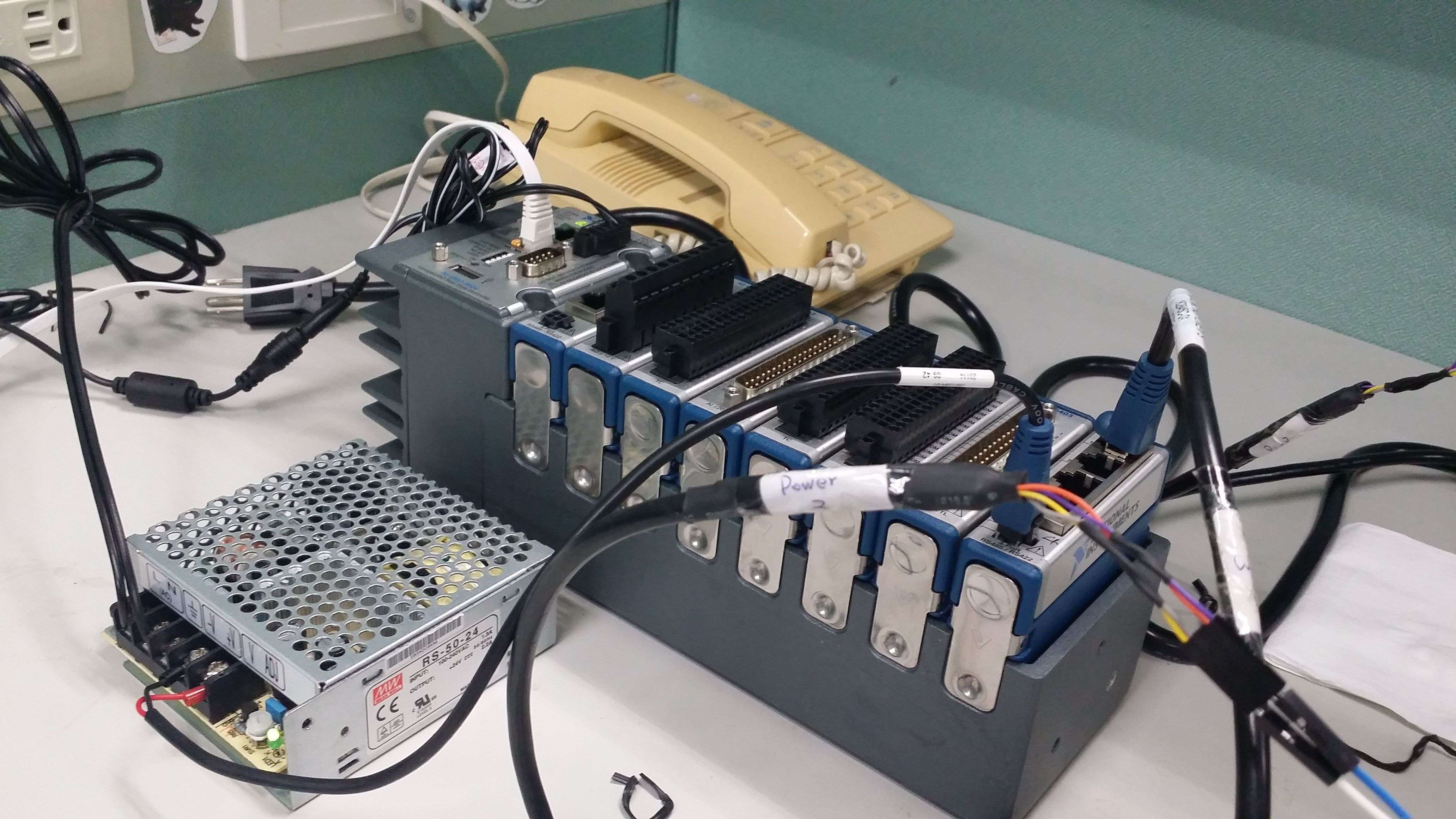

Hi Sam_Sharp,
I'm very sorry about throwing this question without a VI and detailed description.
I have a power meter made from the local factory.
I connect it with the serial port(through a RS232 to RS485 converter) on the NI cRIO 9024, and use the following code to get the data.
Since I have a module of NI 9871, I'd like to move the cable to that module.
I dragged the VI to the target and selected the VISA resource name to ASRL2::INSTR.
I reconnected the cable to the device.
After running the program, it failed with a timeout error.
I wonder if it is possble to use the VISA tools directly in the real time target.
Could someone give me some suggestion?

Hi, Sam_Sharp,
Thanks to your suggestion.
In fact, the communication between the COM port of the NI 9024 and the device through RS232/485 converteris okay.
You can see I can get the data from the screenshot.
The problem happened between the port of NI 9871 and the device without the converter.
I've tried the NI-MAX, but the result is the same.
As a result, I'm still wondering if I can use the VISA toolkit to control the NI 9871.

Hi, Sam_Sharp,
Very thanks to your enthusiastic help!
Yes, the second screenshot is taken from the 9871, in fact, I have not implemented this module successfully.
I also tried to communicate with an ADAM module 4024 but failed either...(it returned the input string as well...)
I wonder if there is something wrong in my setup, but I've read the manual and I think I've done what the manual said.
I connected an external power supply (24V) to the module, and separated the cable into two parts(purple & orange : +; gray & yellow : -) and connected them with the device terminals.
Is it possible there is something wrong with my code? But even the NI-MAX failed to communicate with the device...
Message 7 of 13
(10,308 Views)
Accepted by topic author William1225
When you say the device terminals? Do you mean the device power terminals? Is it a 24V device?
For the 9871 to work, you only need to connect the power to the pins on the 4-way connector block at the bottom of the module. You also need to ensure you have your signal wires connected correctly - check the pin-out carefully, especially if you've wired the RJ11/45 connector to a custom device/connector.
Are you using a 2-wire connection or a 4-wire (full duplex) RS485 connection? I think there is a property node you can set you can set on the VISA resource to select this (and actually...now that I think about it - that might be the problem here):

Hi Sam_Sharp,
You are awesome!!! It works when I added the property node of Wire Mode!
Very appreciated to your help 😄
