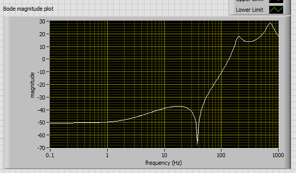

I use a sweep sine signal (0—50Hz) to stimulate a structure, and the response signal after being filtered by a lowpass filter (the cutoff  frequence is 45Hz), is as the picture below
We can claerly notice that the first three modal frequences of the system are 1.6 Hz. 10Hz and 27Hz respectively. Also,the high frequences exceeding 45Hz  have been cut off. That is reasonable.

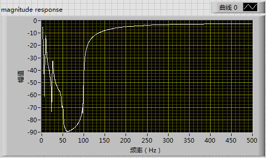

But the problem is ,when I put this filtered response signal into a nonparametric system identification VI with the stimulating sweep sine signal, the frequency character that the nonparametric system identification VI gives is like this:
Yes,we can see the frequency magnitude character that the nonparametric system identification VI gives  is only right  below 50Hz which is near the cutoff frequence of  the  lowpass filter. In fact , if you set the cutoff frequence at 100Hz, the frequency magnitude character will also step up at 100Hz as here in 50Hz.
As this is the system that the nonparametric system identification VI gives, when I want to do a parametric system identification, the parametric system identification VI in labview also gives a wrong result, because it will recognise the natural frequences are in the high frequency range.
The magnitude character of the system estimated by the  parametric system identification VI  is as below:
Right? The use of a filtered response signal leads to a wrong result, in my experiment.

I do not have the System Identiifcation VI so I cannot see what it does.  Does the detailed help desribe how it calculates the response?
If the system response is based on output(f)/input(f), then you would tend to expect a large value for the high frequencies where input(f) is very small.
It may not make any sense to consider the output of System Identiifcation VI at frequencies where you did not supply an input.
