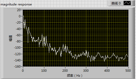

How to understand the relationship between the frequency character and the system 's nonparametric estimation?
Accepted by Lancelot3718
I didn't propose to use a bandpass 🙂
And you can't expect to get reasonable identification results for a frequency region where you didn't provide signals with a at least some information 😉
If you only provide information in a restricted frequency band you don't have/provide prior system knowledge, you can't expect to get reasonable results outside the frequency band provided,
One common way is to restrict the system order to the lowest possible order that still can explain/fit your results. And if you know that your system response is about zero at higher frequencies, restrict your system models to types that behave like that.
Greetings from Germany
Henrik

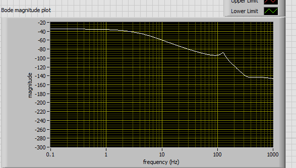

Hi
I have no idea now, and just turn to matlab which can easily give me the right result using the system identification tools.
figure.5:magnitude response of the parametric model identificated by matlabHeart
Thank you again for your help these days.Heart
Greeting from China
Lance
