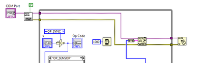

I take a control on front panel which is used to change which Op_Code needs to be send.
Then based on the Op_Code selected in front panel, i created packet in case structure which consist of Op Code + Data Bytes.
Then Out of case structure i calculated the XOR Checksum of the OP_Code and Data Bytes.
Then i calculated the length of packed and add it to the data coming from case structure along with header.
Then i combine the checksum and then send it over serial port every 1 sec.
Here is the block diagram.
I try to do everything with the build array but fails to do so, got some errors.
Now this works but i do have two problems now.
1) OP_SYNC and OP_FUTURE doesn't have data, but still receive its data on serial port, can i do something here such that i didn't get anything when array is empty in case structure.
2) Selecting which Op Code is to be send is done using front panel control but in real application this task must be automated at some frequency, like OP_LED packet must go out at serial port at 100msec and OP_SENSOR packet must go out at 1000msec, how can i do this.
Please suggest.
I am attaching my VI below.

Don't use Insert into Array if you are putting data into an array at index 0.  Just use Build Array.
No need to have the Visa Write be on a wire branch for the VISA reference and error wire going across the top.  Those wires should go THROUGH the VISA Write.
Doesn't your checksum require all the bytes up through the data?  Righ now you are only putting the checksum on the data bytes and forgetting about the opcode and length bytes.
Your not sending the opcode for Opsync or Opfuture.  You are just sending empty arrays.  Meanwhile for the other two, you put the opcode into the data array.  Just wire your original opcode wire into the Build Array.  Get the data element out of those case structures that is supposed to represent the opcode.

Now you are getting into a little bit more of an architecture.  I would encapsulate the code that is inside the while loop as a subVI.  Then with your program's main while loop, use two Elapsed Time Express VI's, one set for 100 msec, the other for 1000 msec.  When an express VI is true, have it execute the subVI with one set of commands waiting for the response.  When the other Express VI is true, have it execute the subVI with the other set of commands.
Does the device respond with anything when you send these commands?  You are only sending data.  I don't see any VISA Read to be able to get any data back.
I modified the block diagram and here it is updated block diagram with both previous one and using build array only, but why it contains to many red marks. Good thing is that it is working fine.
Okay, so what i understand is that, connect VISA Reference and error to Write Block and then to Close block, no need to go directly.
Like this
Yes you are right checksum should be of whole packet, but there is some problem due to which i had to take checksum of Op Code and Data Bytes only. Will correct it in future right now i just want to complete this task.
Actually i want something like , that if array is empty then don't send packet, but i think there is noo need for that, i will simply discard this packet when received at my device.
Creating a SUB VI looks a good idea, This is what i am looking for Elapsed Time Express, i will now study how can i use this in my VI as i am new.
Yes Device will also receive the same packet with information, right now i am sending the query packet only and my device will respond with response, which part is already done and i have to integrate both VI's
And that part is here, and you help me lot in creating that VI, thanks

 The red marks are called coercion dots.  It is telling you the datatypes don't line up and some need to be coerced to another datatype.  That datatype will be the one that can best represent the most numbers.  Because array size gives an I32, all the U8's get coerced to an I32 when going into the array.  Then because you are displaying that into a U8 array indicator, they all get coerced back.
Attached is a cleaner form of that code.

I created sub vi and then using elasped time express vi to schedule when packet is going to be send.
Am i doing it in right way as it is creating confusion in my mind.
Like where do i place serial write, whether it is outside the case structure or inside the case structure, if i place it inside the case structure then i have to provide some data in False case as well, which will trigger some packet on serial port.
Please suggest what could be the best possible way to implement this.
Yes, put the VISA Write inside of the case structure.  You just wire the VISA Resource straight through in the false case.

This is a study in how to ignore data flow principles.  😉 Just because "VISA Close" is to the right of your loop doesn't make it execute after the loop.  Because it isn't wired to execute after the loop - or after anything, actually - it will execute whenever it wants - and probably before you want it to.  Your elapsed time express VIs are not wired to execute after anything, so either one may fire first.  Similarly, the two cases aren't wired somehow together, so either one may execute first.  Similarly, that means any of the "VISA Write" nodes may execute first - definitely NOT what you had in mind.
A more subtle gotcha is that if "Select Opcode Data" isn't set to execute re-entrantly, one instance will have to wait until the other has completed before it can execute.  In the vast majority of cases, this isn't a problem, but if the VI takes a while to execute, it may unnecessarily slow down the application or it may mess up timing.

Put the Byte Array to String and VISA Write inside your subVI.  Everything about how to formulate a message and the actual writing of the message should be encapsulated in the subVI.
(Why'd you change Enable Termination Character from False to True?)
