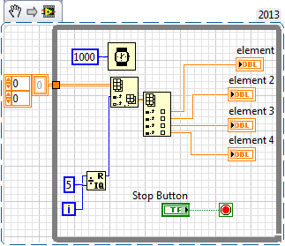

Hi GerdW,
I have tried to modify my code. Now it works. However, everytime when the loop is going to restart, the 1st row of data can't be shown as the index "1" comes in slower than the clock rate. Can you suggest any solution?
By the way, number 5 indicates 5 rows of data. After 5 rowss of data are used, the loop should go back to 1st row of data.
Thanks!
VanessaWen
Message 7 of 12
(7,544 Views)
Well that would be the race condition caused by you mis-using a local variable and using a case structure where a Quotient and Remainder would be prefered
Why is Numeric is a DBL? Why is numeric is an indicator? Why is it on a Shift register?
"Should be" isn't "Is" -Jay
Message 8 of 12
(7,522 Views)
Jeff·Þ·Bohrer wrote: Why is it on a Shift register?
There's nothing wrong with it being in a shift register.  I avoid using the "i" terminal just because it maxes out very quickly when dealing with FPGA.  So you have to do it like this.
