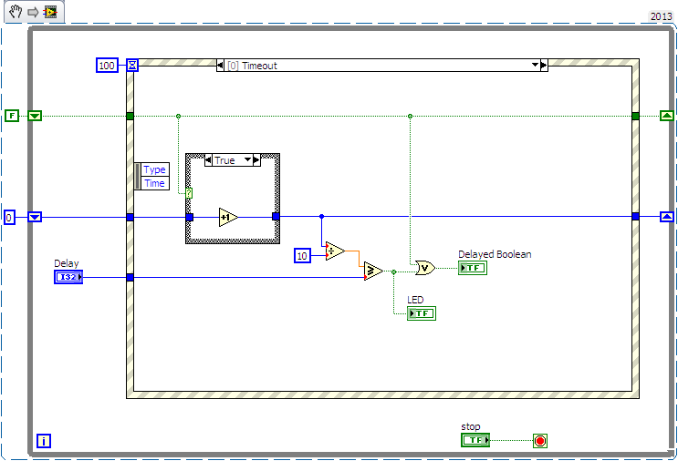

TToolDev01, your solution is close to what I want, I have modified it so that the button depresses on mouse down so that the user knows they have pressed the button, snippet below.
However, I was under the impression it is bad practice to execute code in the timeout case.  In this simple example it is OK, but to integrate this into a larger VI, I can not guarantee the timing of the execution of the timeout case, due to user generated events, locking the front panel etc.
Crossrulz, I think you are suggesting I utilise the timeout case as well, so I am happy to be persuaded that code in the timeout case is OK!
Natasftw, I'm not sure what you mean, but I am effectively wanting the boolean to change mechanical action based on time held, i.e. to latch initially, and then only after it has been held for a certain amount of time (say 2 seconds) change a switch action so it stays depressed.
The purpose is to prevent the user from accidently pressing this button and invoking the action; they have to conciously hold it (e.g. for 2 seconds) to invoke the response.  But I want the user to realise the button can be pressed and is not disabled, hence the state of the button changing when it is pressed for less than the time, but not invoking the response.

You can remove a lot of that logic that is inside of your Timeout case by actually setting what the timeout should be.  So you key on the button's value change event.  With the button going true, you set your timeout to 2000 (2 seconds).  You then perform the desired actions on that timeout.  So when the button goes false, you set your timeout to be -1 (never time out).  You should also set the timeout to be -1 in the timeout case.
