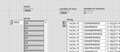

Indeed, sorry I put the wrong file.
I attach it here with the 25 groups.
To simplify the problem of the heatmap, I would like to calculate for each pair of groups (i,j),  the proportion of group i in group j and the proportion of group j in group i. The groups have different sizes.
If I manage to fill in this matrix, then the heatmap will be straightforward.

As already mentioned, I probably would use a map where the key is the group# (I32) and the value is a set of names (strings).
Here's a quick draft. (this works with your original file, ignoring any line that does not start with a <">.)
There are plenty of ways to compare set(i) and set(k) in the stack of loops on the right. Once your description is a bit less ambiguous, we can narrow it down. Modify as needed.
Note that sets only contain unique elements.
