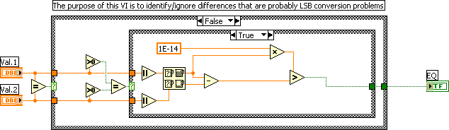

This question is related to the other thread http://forums.ni.com/ni/board/message?board.id=170&message.id=152287, which discusses how to compare two floats (SGLs or DBLs) for equality.
It was suggested to calculate a difference and compare it to a tolerance, but to make such a comparison work over the set of all possible SGLs (or DBLs) seems to require three external inputs to the comparison - unless the tolerance can be derived from the two principal inputs.
I need this function too!
but instead of hijacking the other thread for an answer to my question (sorrySmiley Sad) here it is in its own thread:
Is it possible and/or practical to determine the difference between floats...
... as measured in least-significant-bits in the mantissa of the float?
Thanks!Smiley Happy

... though not looking specifically at bits-of-mantissa, maybe this is close enough(?) - if you see a problem, please share. Smiley Happy

Thank you for the responses! Smiley Happy
Thanks XU, for seriously considering an LSB-arithmatic approach.
Hi Altenbach, your first example was bit humiliating, because it was so simple compared to mine!  But there are a few substantive differences.  Your most recent example requires a multiply and a divide (in most cases.)  The example I posted does a lot of comparing, but has only one multiply.  These operations require different amounts of time, right?  Then again, simplicity's good too!
The need for this compare originally came up when configuration-settings were sent to an instrument then read-back for confirmation.  The float sent (as ASCII) didn't always equal the float, converted from ASCII, read back.  So the goal of the compare was to ignore conversion noise.  For the record, that's why my example treats only same-sign inputs (- sign-change can't be explained by conversion noise.)
Until/unless someone else posts a candidate, I'll probably modify Altenbachs original example to fit my needs (and CC's observations Smiley Wink )
Cheers
