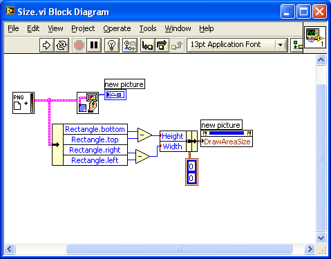

I have loaded an image from a png file into a picture control. I want to size the picture control to the exact image size.  How can I get the size of the image or make the picture control size to image automatically?

when loading the picture you get a cluster with image informations. One of the items is a cluster named "rectangle" containing the size of the picture!

...and then you apply those to the draw area of the picture.
