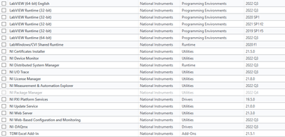

Apologies, I was misunderstanding the question.
This is what is installed on the computer. Is this what you were looking for?
