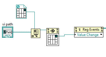

(7,169 Views)
Then you need to use Open VI Ref to get a strict reference dynamically.
Message 10 of 15
