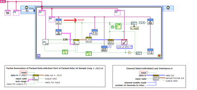

When I implement FPGA on LabVIEW, every functional units on FPGA are SubVI-ed and "reset" terminal is placed so that it allows synchronous reset.  Below is a small peace of my development for an example.   When reset signal is asserted all SubVIs accept that reset signal and synchronously reset.
If any of your logic requires multiple clock cycles to reset such as resetting clock-crossing FIFO, that unit (SubVI) may provide "in reset" output which indicates its on-going reset process.  Careful considerations for reset is especially important for FPGA.

@umaso
Even in this example your "detect falling edge" is not actually being reset.
The trouble I'm facing is that, especially with all of the pipelining going on, there are too many things that "need" to be reset.
"need" is in quotations because this isn't an actual problem on the FPGA. They are reset when the bitfile is loaded and ran and that is good enough to get into a steady state
My use case is just for running back to back tests (running the fpga logic the host) from a known stable-state.
Of course, I *could* add reset logic to every single feedback node but i'm really looking for a less intrusive way to accomplish this just for the purposes of testing.

In that case you do not like to explicitly add reset logic for all the feedback nodes such as the ones with pipeline delay more than one, I would do the followings.
1. calculate the longest clock cycles to push all the residual data inside those feedback nodes as well as any state-holding logics more than one clock cycles.
2. Latch reset input and hold a reset signal until the number of clock cycles elapse which is calculated in step 1.
as for the falling edge, it does not require reset.  I recommend you to first design before implementation.  Draw state machine diagram including resetting state.
