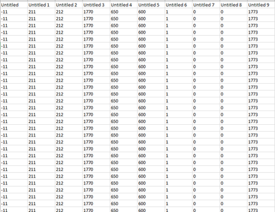

I want to add date and time to the first column of the array and want it to keep updating at the same rate as the values that are being read from the Modbus. But I am not getting how to add to an already existing 2D array.
(column names are yet to be renamed)

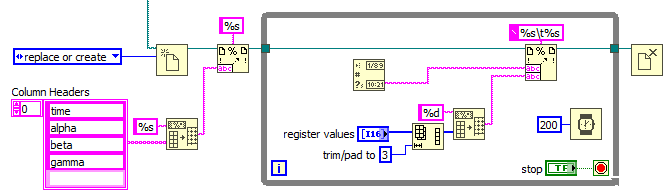

@girish_jadhav wrote:
It doesn't have to be excel. I will try it with plain text file as well.
Here's how you could write a simple tab delimited text file that you can open in excel. (Just a draft. Add error handling, etc.)
Write the column headers before the loop, then append rows until done (using "format into file" and array to spreadsheet string).
