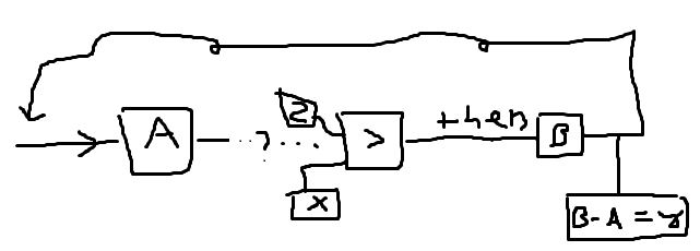

I want to make something like:
Where A and B are both the current time x is a constant, z is a variable and y is change in time.  I know the > needs to enter into an "If" loop but I'm not sure how to keep A and B at the same time and how to get the integer y out of the "If" loop.  After the program solves for y I need it to continue looping inside the main system indefinitely.

There is no such thing as a "if" loop in LabVIEW. We have FOR and WHILE, and you are probably looking for a while loop.
Take a tick count, feed it in a feedback node, and subtract the previous value from the feedback node output whenever the condition is met. Repeat forever.
(To get access to Y value in a different loop, use a local variable, action engine, or queue, for example.)

"Loop indefinatly" most often means "Loop until i press stop button" 🙂
Create a boolean control and wire it to the stop of a while loop.
