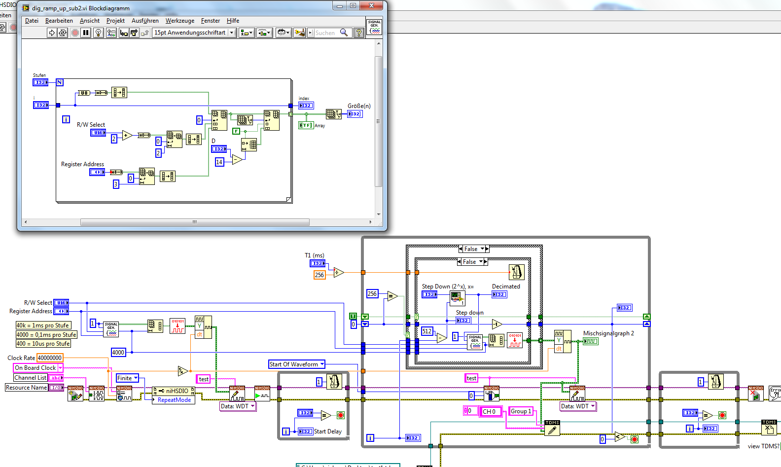

hi everyone,
@crossrulz: I'm using LV 2010 Proffesional Development System, and too bad I couldn't find that VI in my LV.
@altenbach: sorry for my bad english :D, I'm gonna try to clarify what I meant with array of sequences here:
I'm building boolean arrays (in attachment: dig_ramp_up_sub2.vi) of 14 bit boolean (2bit for read/write, 3bit for address, 8bit data, 1bit of 0).
I'm using that VI as a sub-VI, and using index of outer while loop (as in pict) to generate Ramp up, Hold, Ramp down (like what I got from other thread in this forum).
My clock frequency of my HSDIO is 40MHz, which means, each boolean "T"/"F" has period time 25 ns.
each step of Ramp consist of 14 bit, which means 14 booleans = 350 ns of time. I'm using D just for delay.
and I can control time (dt) of each step generation of ramp by controlling the wait time of case loop.
Easy for ramp: I can make sequences of 0,1,2,...,255, then hold, then sequences of ramp down: 255,...,2,1,0.
With using outer while loop index as input to my sub-VI, I'm writing my steps into my HSDIO card at each iteration. I'm generating my ramp in only 1 channel.
Maybe I should say "Sequences of boolean-arrays" instead of "array of sequences".
Now I want to be able to generate sinewave, which should have: Amplitude, Cycle numbers, Samples/cycle, Sinewave freq, Sampling freq, which controllable.
And I was thinking to generate sinewave using the same method as I generate my ramp.
But no, I don't think I can do that, since I can't use the same sequences of numbers to generate sinewave, when I use different sinewave freq and different sampling freq for different test.
Yan.

hi all,
I have one quick question;
how do I control the execution time of my case structure? as you see, I have several case structures in my VI. And I've put a "wait until next ms multiple" in the structure. But I don't think I'm getting precise time result while generating my 256 steps ramp up and 256 steps ramp down using T1. I've tried to check the time with using tick count before and inside the main while loop and I keep getting weird results.
When I generate my ramp with T1 = 1 ms or T1 = 100 ms, and hold time 1 sec, I'm getting the (relative) same result (1070 ms  ~ 1110 ms)
when my T1 = 200 ms or 300 ms, hold time 1 sec, same result ~1500 ms
when my T1 = 400 ms or 500 ms, hold time 1 sec, same result ~2000ms
And I dont know how this result occurs.
What I need actually, when T1 is 100 ms, the ramp up is generated in 100ms, then hold 1sec, then ramp down is generated in 100ms, which means I should have ~1200 ms, or
when T1 = 200 ms; hold time 1 sec; result = 1500 ms
when T1 = 300 ms; hold time 1 sec; result = 1700 ms
or I can say my result should be 2.T1 + hold time. But it seems not running that way.
Any help pleasee...
Message 17 of 17
