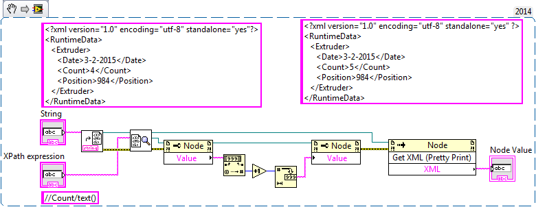

How do I edit an element's value in an XML file?
Seems like I may be overcomplicating things.  I created a vi that can read an xml file that I manually created but also need to edit element values.
For example i want to edit element "Count" from 4 to 5 in this xml file:

I believe you need to use the value property

I really do think you need to check out the W3Schools for XPath info, makes life easy:

Darin,
You are probably right about checking out W3Schools more but that wasnt my problem.  Since i dont use Labview on a day to day basis, i failed to remember that I can change the property of the node from "Read" to "Write" ... a big DUH!!!
I knew it was something simple!
Thanks for your feedback!!! Much appriciated
