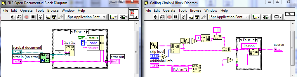

Absolutely! and I tried to explain it in my last post. But ok, since pictures say sometimes more than 1000 words here you go.
The right side is a function that checks to see if the file exists and if it does attempts to open it in the external viewer that is registered on the computer for this file type. If it doesn't (which is shown here) it generates an error message and puts it in the erorr cluster. The diagram for the VI generating the Call chain is shown on the left. Skip level is used if the actual Call Chain VI might be buried deeper in the hierarchy of error helper VIs to exclude their names which would add no extra information.
For instance building the error cluster could be also put in a subVI if you happen to have that often for instance with API Calls that only return an error code. In that case I have usually a library specific Build Error VI, that receives the error number (usually 0 means success and non-zero is the error code), and creates the Call Chain and then puts that and the error code in the error cluster. It could also incorporate a call to an API to add error specific text information to the error message, if that API supports that.
