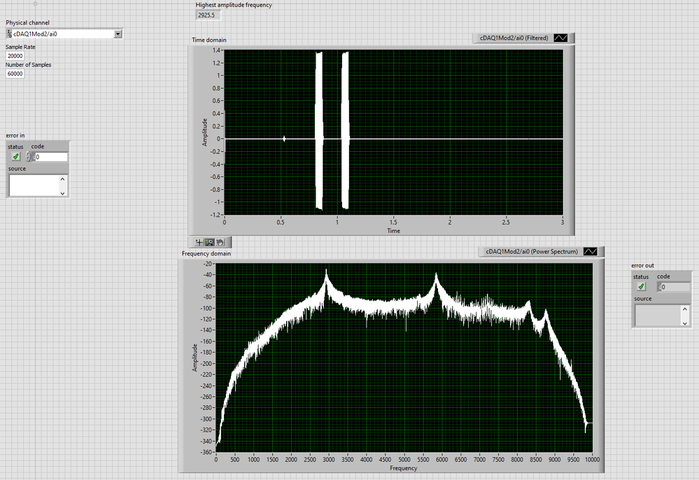

I'm writing a VI, which uses a cDAQ 9205 connected to a microphone, which is placed directly above a PCBA which has a buzzer. That buzzer buzzes 5 times when something fails during the test, and at the end of the test, it will buzz 10 times if everything passes.
I want that VI to be able to give me a count of the buzzes. I've been able to get a very nice analogue waveform out of it, but counting peaks using native VI's hasn't worked for me.
NB: This will run asychronously in TestStand, but I don't need help with that, I just need help counting the peaks. Once I got that sorted out, I will be able to continue from there.
Here, I listen for 3 seconds, at 20kHz. The buzzer beeps twice, and I get a very nice time domain waveform. See below.
However, if I zoom in on the waveform, it's not a square wave. It swings. So built-in peak counting VI's yield massive overcount. I want this example to give me a count of exactly 2, instead I have hundreds.
I was wondering if anybody could give me advice on how to do this. I was thinking, like I said, either some debounce feature, or some analogue-to-digital translation, which gives me a nice way to count the peaks. I've tried various analogue filter VI's, and the problem is not resolved.

It would also be helpful to provide some sample data for different buzz patterns.
Nonetheless I generated a dataset that looked reasonably similar to yours and found that I could get an accurate count by tweaking the input parameters to the peak detector.
Essential ideas:
- take the absolute value of the signal
- use the Peak Detector function with an extra-large width.  Make it a little wider than a single buzz burst (which I estimated to be 2000 samples at 20 kHz, i.e., 0.1 sec).  I also set the threshold to 1/2 the buzz amplitude.   Small variations in those parameters didn't affect the accuracy of the count.
Caveats:
- I simulated a buzz as a 0.1 second sine wave burst superimposed on a 15 mV noise floor.  I tried a few sine wave freqs from 500 to 3000 and all worked fine.  Your signal may be more complex, but I'd expect some kind of similar approach could be made to work.
Notes:
- initially I tried lowpass filtering after taking the absolute value.  It worked out fine too, but it turned out not to be necessary.   The peak detector worked anyway, once an appropriate threshold and width were chosen.
-Kevin P
