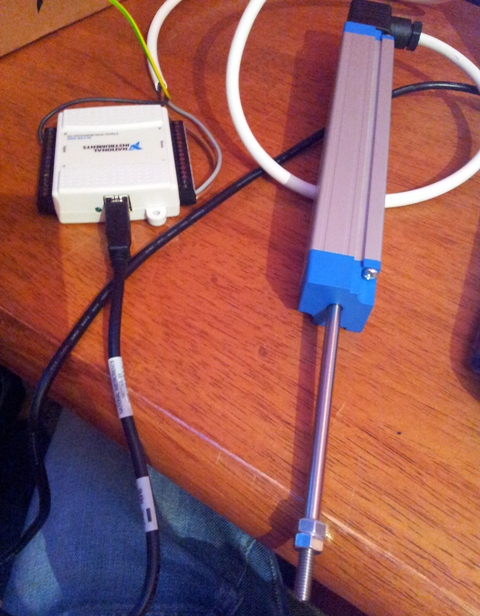

I have a DAQ 6009, linear potentiometer and a spring.
I want to measure the displacement of a spring using the linear pot and correspond this displacement into a force by multiplying by spring constant k. (F=-k.x)
F=force, k = spring constant, x = displacment
I need to create a VI that will,
  • Take voltage readout of potentimeter and correspond it to  0-110mm displacement of spring. ie 0V=0mm, 5V =110mm.
  • Multiply the displacement mm by k (which is 25).
  • Record values into excel file and display when stop button is pressed.
  • Record peak force (amplitude).
  • When the pot is fully extented it would correspond to 0mm/0V.
Please find attached current Labview VI and linear pot.
As you can see it is multiplying the voltage reading by 25, I want to correspond this voltage to a displacment and then multiply by 25 so I will have output in Newtons.

Pretty pictures but no one has any idea what you did in the DAQ Assistant to set your scale. You did use a custome scale in there, didn't you?

Click on the Custom Scale option in the DAQ Assistant. It would be a scale factor of 22 (110/5).
I or no one else can debug a fuzzy picture.
