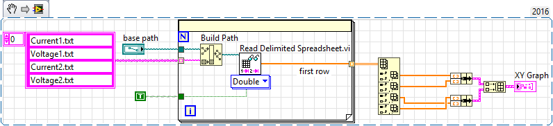

Hi Mayur,
On my second data you can see there is Current on Y-axis and Voltage on X-axis. So want Voltage on X-axis and Current on Y-axis.
And what is the problem?
Voltage=x axis, current = y axis - just like you want it to be!
As others already said: attach your VI!
Show how it currently works and also show how you want it to work.
Tell us the exact problem you have in reaching your goal!

Sorry my mistake. From second data I want Voltage on Y-axis and Current on X-axis
Message 12 of 16
(1,965 Views)
You can use Swap Values to swap the X and Y data before bundling... This is btw the same as swapping the input files to begin with.
You might want to flip the axis. For that you need to get a scale reference and set the Flipped property.
Maybe, just maybe, it's a good idea to post the VI?

Hi Mayur,
When you want the voltage data used for Y axis you need to wire it accordingly for this BuildXYGraph expressVI!
So you aren't able to change the wiring in your VI? Or to implement a case structure with a switch? Or to use the Swap operation suggested by Wiebe on your own?
Did you take the free beginner courses offered for free by NI on their website?

is this what you want? i got confused.
