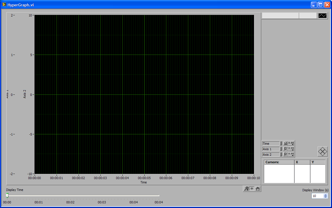

I have a graph with 2 Y axes that is exhibiting a movement of the left most Y axis when graph has it's expand to pane option enabled.
Here is a shot of this starting to happen...
As I mentioned it is related to the autosizing and also to my programmatic writing to the graph Y axis  scale.Increment, MinorInc, and RngStart properties.
I do need to be able to have the graph autosize and also would like to be able to manipulate the Y axis grid lines to emulate the clean  look of the hypergraph.  I have really tried everything I can think of to prevent this or to be able to restore the Y axis (which you can do in edit mode).  I am working in LV 2011 but it also the same in LV2010.  Incidently, I do have the graphs y axes set to adjust the plot size as needed so it should make room for itself automatically, which it does when the graph has not been autosized to fit the pane.

I think it was Christian that found that
Advanced > Reset Scale
and
Auto adjust
have an effect on Y-scales postions. If you have not previously you may want to try those.

Hey Ben,
Thanks for the reply...
I do have 'Auto Adjust Scales' enabled and it does work as expected except for when the vi that contains the graph autosizes which in turn triggers the graph, which is set to also autosize.  Then the Y axis position gets hosed up.  In edit mode you can right click and reset the scale layout, but I cannot find a way to do that when the vi is running.  I can programmatically set the left border of the plot which will move the wayward y axis back in view, but I am not sure how to detect, other then visually, when I would need to do that and also what to set it to.

sachsm,
Try unchecking the 'Autio Adjust Scales' option and see if that solves your problem. This has resolved the issue for someone in the past.
Actually, it is:
Advanced > Reset Scale Layout
Message 5 of 12
(6,029 Views)
Yes that is the correct name and it does correct the y axis creep, bur unfortunately it is not available programmatically.

sachsm,
I believe that is the only solution available at this time. We hope to have a better fix in a future release of LabVIEW.

Just to be clear... the reset scale layout is only available at edit time.  It is not available programmatically or via the right click menu of the graph control.

Ben,
This issue was reported in CAR ID#302673, and is being actively worked on by our developers. Unfortunately, I can't make any specific predictions as to when this issue will be resolved, but feel free to reference that CAR number in the future to get an update.
Renée M
Applications Engineer
