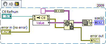

If the reference will always be to 1-D array (or perhaps as long as the number of dimensions is always the same), there's an easy way to do this.  You can use "Variant to Data" to convert a Variant (that contains an array) to an Array of Variants, and then use Array Size:
Message 13 of 22
Yeper!
The more we know about the data the easier it gets.
Ben

Probably worth noting as well that you can get the array dimensions from the control reference by getting the Value property (as a variant) and feeding it to GetArrayInfo in the VariantDataType library (vi.lib\utility\VariantDataType).  That VI also has an output called "Array Lengths" but unfortunately it doesn't actually get you what you want, since it returns that the array lengths are variable.  It will only return real values for fixed-length arrays such as used in FPGA, or bounded arrays (no idea when they're used in LabVIEW).

With an assist from vi.lib:
..\vi.lib\Utility\VariantDataType\GetArrayInfo.vi
(I actually only have used this for finding NDims, never bothered unbundling the Lengths).
Unfortunately, as I noted just a minute before your post, this doesn't work for finding array lengths.  Each dimension gets a length of "Variable" and 0.
