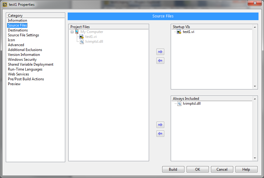

This is an old thread, but I ran into the exact same problem in LV 2014.  Guess this very simple bug is still not fixed.  The provided work around did the trick.  I searched within my Labview install folder for lvimptsl.dll and copied it into my project folder and then drug it into the project explorer and placed it next to my VI:
I then opened the build specification properties and set the dll as always included:
And then changed the destination path to "resource":
I rebuilt my application and all works now.
Thanks for the work around and Kudos to you.
