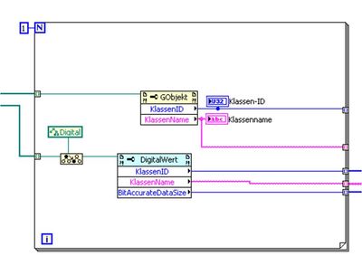

I have a cluster with several controls.
I would like to get the type of each control inside of it. To get the class is ok. This is simple and all of them are Digital. But I need to know if they are U8, U16, U32 ...... I64.
Any idea how to do this?

I got it.
I had to Convert the Element Refernce to Digital and then to use the property BitAccurateDataSize.
I lost several hours to find the solution and in 5 minutes after I had posted my problem on forum I solved it :).

Another way I do it.
(3,722 Views)
Darin,
What you used is even better. Thanks.
