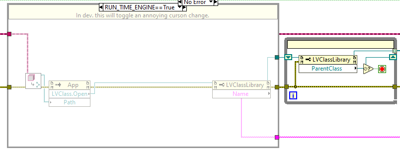

is there a way to get parent class name programmatically from child class that it's working in run-time vrs 2018? I tried to get it by reading the .lvclass file - in LabVIEW 2020 it seems that there is an item named "Parent Libraries" that contains the name of the parent class and the relative path to the parent lvclass file but in LabVIEW 2018 that item is missing from the file. Instead, I think they use "NI.LVClass.ParentClassLinkInfo" property which is "encrypted" and I have no idea how to get useful information from data listed there.

Thanks Wiebe, I know about that thread. The solution presented there does not work in run-time. I need it to work in run-time because we have a test sequencer developed in LabVIEW which is able to execute class method VIs but when dynamic dispatch VI is called and the current class does not have an implementation for that method, I needed the parent to check if it has that method implemented and call it. In the meantime I found a solution by calling 'Get Implementing VI Path' method from App -> LabVIEW Class. For some reason this seems not to work every time but could be something wrong in my code, I didn't have time to investigate in detail.
Still, since the parent is a dependency of the child, I would expect to have an easy way to get the parent name or path.
You can use this during Run Time.
It works during development, but you'll get an annoying wait cursor when you call it.
