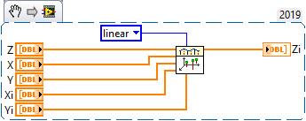

I'm looking to put about 50k data points through the linear interpolate process of this VI:
https://zone.ni.com/reference/en-XX/help/371361R-01/gmath/interpolate_2d_scattered/
It works, barley, but takes much too long for my desired application.
I understand from this article, and a friend in CS, that I can use my GPU instead of the CPU to change this into a trivial task:
https://knowledge.ni.com/KnowledgeArticleDetails?id=kA00Z0000015AcdSAE&l=en-US
Before I embark on this journey alone, I wanted to ask if anyone has experience doing this or has already done it before? If so, is there code already out there?

Have you tried speeding up the CPU code to see if you can make it fast enough? Make a copy of the Interpolate 2D Scattered function, and just isolate the code path you're using. I presume because you're talking about the AxB function that you're using the biharmonic spline (Green's Function) interpolation. One thing to try is to parallelize the outer For Loops - depending on your machine, that might give a 5-10x speedup. A second would be to install the Multicore Analysis and Sparse Matrix Toolkit and replace the matrix calls with the corresponding MASM routines - these are typically much faster.
The Green's Function interpolation is almost identical to a simple Kriging interpolation, which I tend to use for 2D or 3D interpolation. The code I've written here has a different way of passing the positions where the information is all in one array. Note also that instead of solving the linear equations directly (the Disabled code), a pseudo-inverse/multiply is used, otherwise there can be problems with an Interpolation Position that is exactly at a Data Position (also an issue with the NI routine).
Again you can replace parallelize the For loops and change to MASM matrix calls to speed this up further - I've done this in the LV2018 VI attached. One further speedup here is using SGL arrays which MASM supports directly and are typically several times faster than DBL arrays.
A big advantage of this method is if you have a set of fixed Data Positions that have changing values. Then you can compute the Weights only once at the start, and just call the AxB matrix function with each new set of Data Values.

Greg,
Thanks! I'll try this today. To be clear, this is the function I'm trying to replicate:

I think altenbach's Trilinear Interpolation assumes that the source data is on a grid, so not scattered.
In terms of using the Kriging vi, I created this quick demo to show how the VI attached above maps to the Interpolate 2D Scattered data organization.
