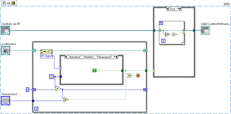

Take this example.  A sub-VI receives a VI Reference and an Array of references of Controls on that VIs FP.  In reality we have the option of receiving many different arrays for different functionalities, and not all are guaranteed to be valid (Empty arrays, default values and so on).  Therefore we are required to make a sanity check on all of the references.  If you wire a single invalid reference to the "Register for Events" then all registrations below this int he same node will not work.  For this, we need to wait for the FP to open which we ensure by polling the FP.State property and progressing as soon as it is "Standard", "Maximised" or "Hidden".  We immediately then perform the validity check ont he references.
Problem: Sometimes the first few comparisons return "invalid" for the references even though we know that it should be valid.  If we repeat the action a few seconds later, everything works fine as expected.  The behaviour would seem to indicate a difference in time where the FP-State property gets set to tha appropriate value and the FP actually being loaded.  When running this code in the IDE we never encountered a problem but in our built EXE customers have observed that certain buttons have no function which we have managed to narrow down to this issue.  Sounds like a typical race condition, right?

Hi all, here's Intaris' co-worker who encountered the issue, with more visualization material. Important to know is that these reference values get invalid only in compiled code, it never occurs in development. A printscreen of the code section where the issue occurs. It's in a subvi that prepares the control references for dynamic registration.
References are gathered and reshaped into a 1-dimensional array (as 2-dimensional arrays cannot be dynamically registered) and to remove the invalid references, there's this subvi with variant connectors, a printscreen of the block diagram here below:
To debug we tried to add some additional checks and wired the values out of the subvi.
So we found out, that sometimes - and not always reproducible - the first or the first two values of an array of (mostly three) references are zero and invalid, even that before the subvi, they're still non-zero and valid. This control reference check vi with variant connectors is inlined, interestingly the issue that a reference gets invalid never occurs (in about 50 tests) when we don't inline the subvi. So we suppose now it's a Labview bug that is related to inlining and the front panel state being "hidden" (it never happens when the FP is "standard"). We have also the impression,  the probablity it occurs seems to be related to some PC environment (performance, execution time?), as customer reported this issue to be reproducible on every run of the application.
Anyone else encountered a similar issue already? Right now we'll go with the workaround to not inline this reference validity check subvi.
