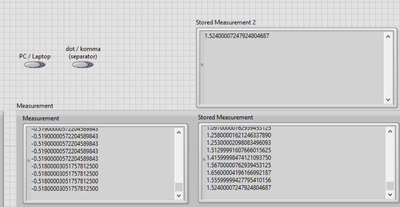

here is my code and the display on the front panel, here you can clearly see that i get the full data from the Arduino (or am i getting something completely wrong here?). The thing is that after the conversion to numbers i loose all of the digits except for the 3 after the comma. So i guess i have something wrong with either the conversion or so, so i will try to just save the string immediately and just convert to display the numbers even though the plot wont be 100% correct then. As you can see here i get all the data in LabVIEW just after the conversion and saving it it only Shows the 3 digits (also on the probes in LabVIEW itself as you can see in my first post).

Two things to check.
First: how is the display formatting set in Excel for column B. The default is %.3f because.....well, it's a spreadsheet.  BTW, Excel handles math a bit differently than the IEEE 754 standard for some cases.
Next: let's see the configuration inside the Express VI.  One of the reasons they are so hated is that they hide what you told them to do and don't have a default that fits every use case..
Essentially, you are getting yourself confused.   What you see in LabVIEW Front Panel Controls / Indicators and in Excel cells are text strings.  Known as a object's Display.Text.Text property.  A Value property is much different and is formatted into a display string by the owning application.

Hi mismatch,
Then why did you present completely different data in your attached VI?
How should I know the data you show now?
It could be so simple, once you get rid of ExpressVIs:
Why do you create a filepath with a ".csv" file suffix, but use the ExpressVI to create a XLSX file???
(Using the WriteTextFile function you can use a .csv file suffix.)
Edit: use the file reference coming from your FileOpen function instead of the file path to avoid overwriting the text file again and again!

@Mísmatch wrote:
hey ,
First: i tried to increase the commas and excel just adds 0 after the 3 digits, also LabVIEW already only Shows 3 digits with the probes.
next: here a screenshot of my configuration of the Express VI.
Mismatch
See that Advanced button?
That pulls up a page that configures formats.
Probes in LabVIEW (Actually "Smart Probes") have a default format too!  Create new Probe with a %.20f specifier.  Just right-click the orange wire to launch the wizard.
"Should be" isn't "Is" -Jay
