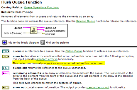

Help file says that "This node runs normally even if an error occurred before this node runs."
Are you positive that you are getting an error and not a warning?

aputman ha scritto:
@pincpanter wrote:
If you wire the error into the Flush Queue node, it will not be executed.
LV 2011 help does not say that. I verified this with a little example.
Typically only Close nodes run even when 'error in' is true (and Release Queue does).
Paolo

Accepted by topic author mzema
I did a quick test and the flush function does not operate if an error is passed in.  As stated this type of functionality is generally reserved for closing operations, which you want to still release hardware or resources even on close.
