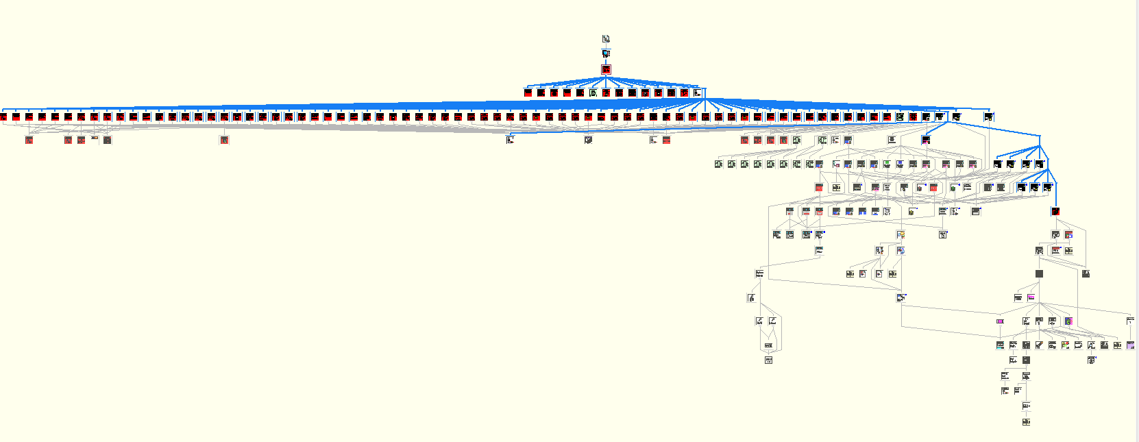

I'm not quite sure what you mean by "how do you use the heirachy view". I usually creates small applications and haven't used the heirachy view before. Now I have a rather big application and the heirachy view is more confusing than this sign:
My Heirachy:
At least I can tell which are my iconsSmiley Happy
Even
My Heirachy:
Well, E DJ
Start a new thread- PM me to get my attention!
The heirachy view should help you visualize your code--- not confuse it!---- tips and pointers from the best of us might just adjust your  icon style positively.Smiley Surprised maybe mine too !  though, I keep a nice stash of icon templates that serve ME wellSmiley Very Happy
