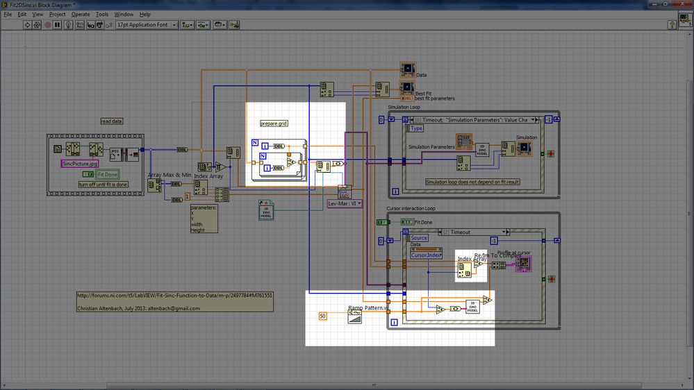

Also remember that formula models are relatively inefficient. The VI models is recommended if significant processing is involved. Here a picture of the model. Simple enough? 😄
(Note that the base grid is sent as a complex 1D array in the data variant to simplfy coding. The "width" units are arbitrary, scale according to your requirements)

@altenbach,
First, thanks for taking the time to write this awesome program. It is very helpful and very cool indeed.
Before I make use of this, may I pick your brain a little? I want to make sure I understand how it works because I don't want to plagiarize your program. The areas I do not understand are highlighted below.
I am mainly having trouble with your use of complex numbers which you mentioned are there to simplify coding. This is probably because I am not a computer scientist :). (I am an undergrad. Physics major.)
This "prepare grid" section seems to be working its way through the pixels in the image and creating complex numbers out of their indices. Then this array is then resized and sent to the data terminal of the LM.vi. Why is this needed? I have noticed that when I remove this step I get the error, "The system of equations cannot be solved because the input matrix is singular."
I am also confused about the use of the Ramp Pattern.vi. As I understand, you are making 128 complex numbers out of the cursor position index and the ramp data, then feeding it into the data terminal of the 2DSinc2ModelComplex.vi. Then another complex number is made out of the ramp pattern array and the f(X,a) output of the sinc. Why is this needed?
Something similar seems to be happening in the highlighted area above the ramp section. If you could try to clarify the use of complex numbers a little I think that would help me. My searches online have not been effective.
Thanks a lot, Mr. Altenbach.
-Patrick
Message 9 of 18
(10,994 Views)
