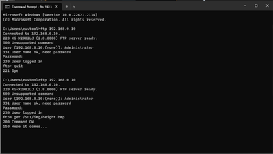

Hey y'all,  I'm currently trying to FTP a couple of files off of a Keyence controller onto the local machine.  I'm able to use FileZilla to open the connection and even download the file, but when I try with LabVIEW (using the "FTP Get File.vi") it gets stuck at the transfer step and then errors due to a timeout.  After this happens I'm not able to FTP into the controller again (even with FileZilla) until I reboot the whole controller.  Looking through the VI it does looks as old as dino dirt so I wouldn't be surprised if the vi is depreciated, but I haven't seen any post or anything about it.  Any ideas on the LabVIEW side that I could try to make sure it's not LabVIEW and is, in fact, something to do with the Keyence controller?
Edit: Been running through some of the sub VIs and it seems that the place it gets stuck at is the Open Data Connection, on the wait for listener.vi
Edit 2: I've just confirmed that a similar behavior is observed when using the command prompt, so I don't think it's labview.  If anyone knows anything about Keyence I'd greatly appreciate any help, but as I see it, this is not a LabVIEW issue.  Thanks

I've tried and it still doesn't seem to work.  I think the fact that it doesn't even work from the Command Line makes me think it's more of a problem with Keyence.  It's been stuck at this "150 Here it comes..." for > 30 minutes

Got it Babeyyyy! Had to set Active to False and Binary to True, as well as had to save the image at 1/8 resolution so it would go faster.  When Binary was False, I still got a picture but it seemed a little off.  Also, if you're going to sniff packets in the future, LabVIEW only sends and receives TCP and FTP-Data Packets, no FTP packets are actually sent/received
