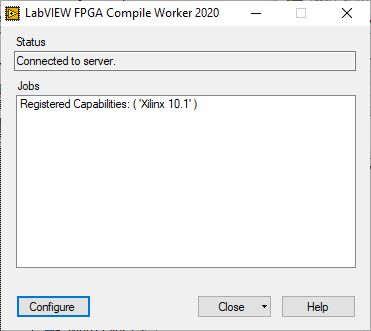

But on your screenshot is
which requires ISE 10.1
I tried occasionally the "opposite" wrong setup (using ISE instead of Vivado) with my 9054 and it didn't work.
I've got also Windows compatibility issue using LabVIEW FPGA 2018 on Windows 10, then migrated to the latest version, and only then it works for me (still warning that the build might be not supported, but works).

@Andrey,
I've tried to remove Vivado and installed ISE 10.1 through here, and now configuration looks like this.
Weirdly enough, even though the compilation error is the same, it says it is using Xilinx 14.7. I'm not sure if it is refering to ISE 14.7 which I don't remember installing or if it is supposed to be that way.

Accepted by topic author DanielAgos
Unfortunately, Xilinx ISE is not supported on Win10. You can either install the compilation tool on another Win7 machine or use Compile Cloud Service (if you have the SSP.)
